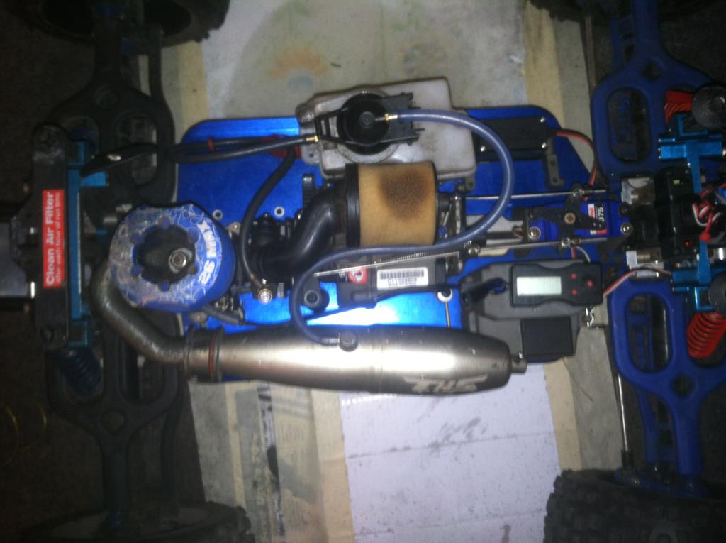

Use a metal coat hanger and cut and bend it to go from pipe mount hole with set screw to chassis behind receiver box. Use a 3x12mm nut and bolt with washers to secure to chassis. I say use coat hanger because its actually stronger than the pipe mount wire or spring that is used stock. I've broken several stock ones till i cut one out of a hanger.
Zoom in on the pic and you can see where the hanger is coming across the chassis just behind receiver box to underside of pipe and then bends up to go thru mount hole on end of my pipe. I also bend mine over the pipe in case the set screw comes loose it will still hold pipe in place. Yours will be on side of pipe opposite of the stinger i believe. Wont be as big as the pipe in the pic here.
