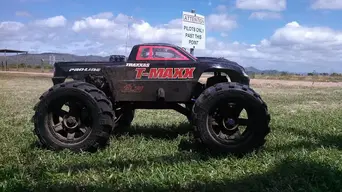

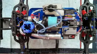

Started life as a 4907.. As most would agree it would of been cheaper to just but the components seperately.. Anyways.. Very happy with it now :D
Mods include..
OS 21 TM (awsome engine!)
Traxxas Al front and rear bulkheads
Futaba S9351 steering servo
Ofna fuel tank (excellent mod)
1600 mAh receiver pack
Emaxx servo saver
RPM arms front and rear
RPM shock towers front and rear
Revo front pillow balls
Traxxas Al steering servo mount
Traxxas Al throttle servo mount
Proline rims with Masher tyres
Emaxx brushless diffs (120,000 front and 100,00 rear wt oil)
Traxxas BB shocks (50 wt oil)
RC raven srpings (brilliant springs!)
Savage rear driveshaft (hpi..:\)
MIP clutch
AVID bearings
Spring mod on the brake disks (another good one)
Thanks to all the guys on this forum, there is a wealth of knowledge here.
You've got a solid truck there, you've upgraded the known weak points.....pretty awe-inspiring. (Just for you Rolex)
Great looking tmaxx. You covered all the problem areas and then some.
