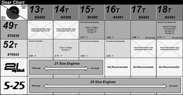

Just curious as to what gearing would be best for my .21. I am using stock at the moment and its very quick but i want to give it a little more grunt at the bottom end. Any suggestions as to which combination of fly and spur will give me a little more power but not put too much stress on the other parts of the truck.
I have this chart to look at but it does not tell you from experience what is the best setting.
You are currently at 52T/14T (3.714 : 1). Your only option for more low end is a 13T clutch bell unless you go with gears from another vendor. The 13T clutch bell with the 52T spur would bring you to 52T/13T = 4 : 1
Cheers for that Rossb, will be getting one from my LHS soon. Have had lots of choices thrown at me but did not want to damage the other parts of the truck that may not be able to accept the extra torque being thrown at them.
