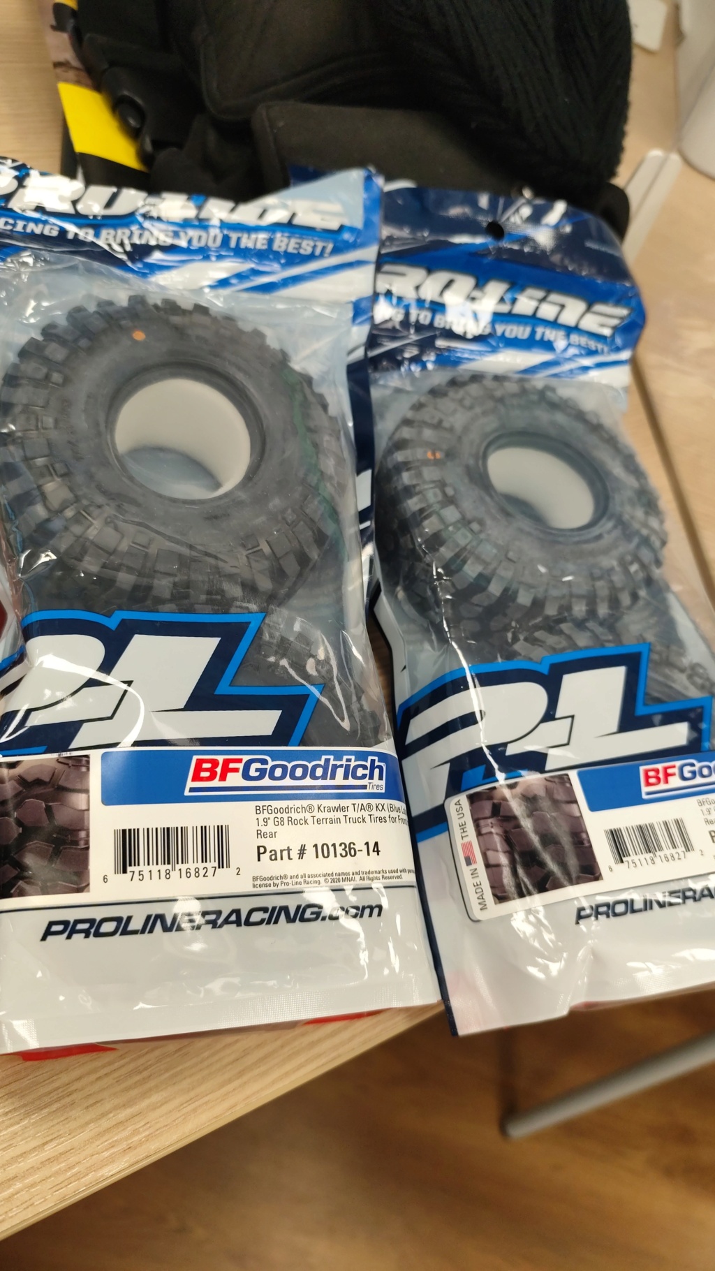

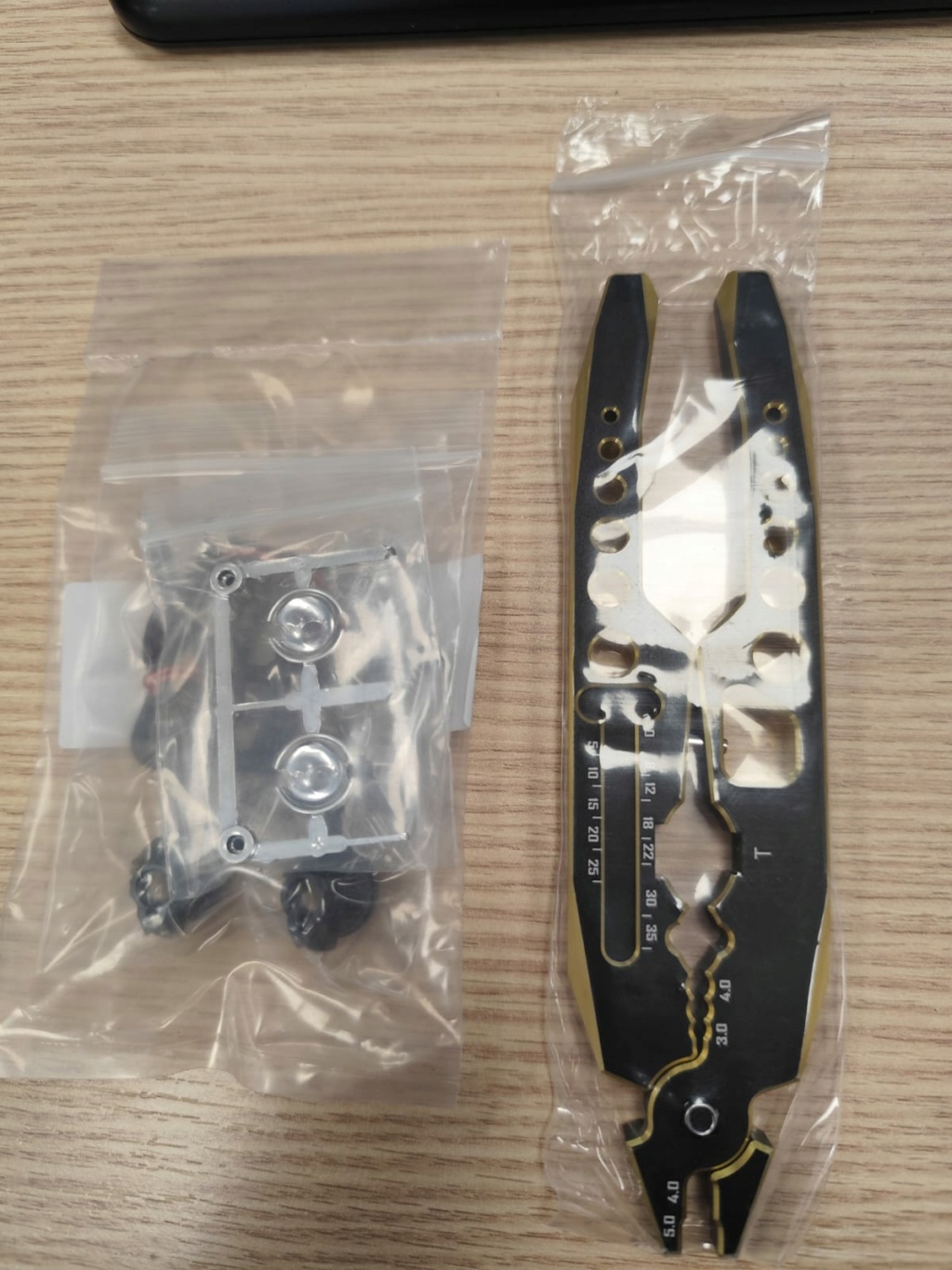

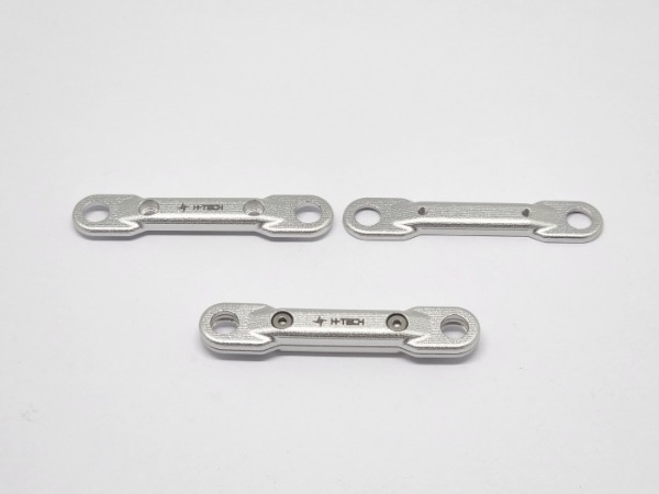

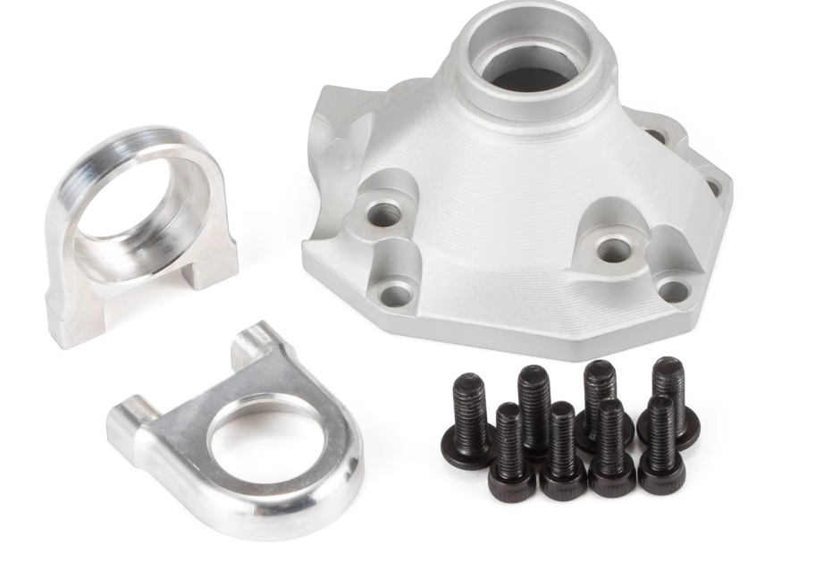

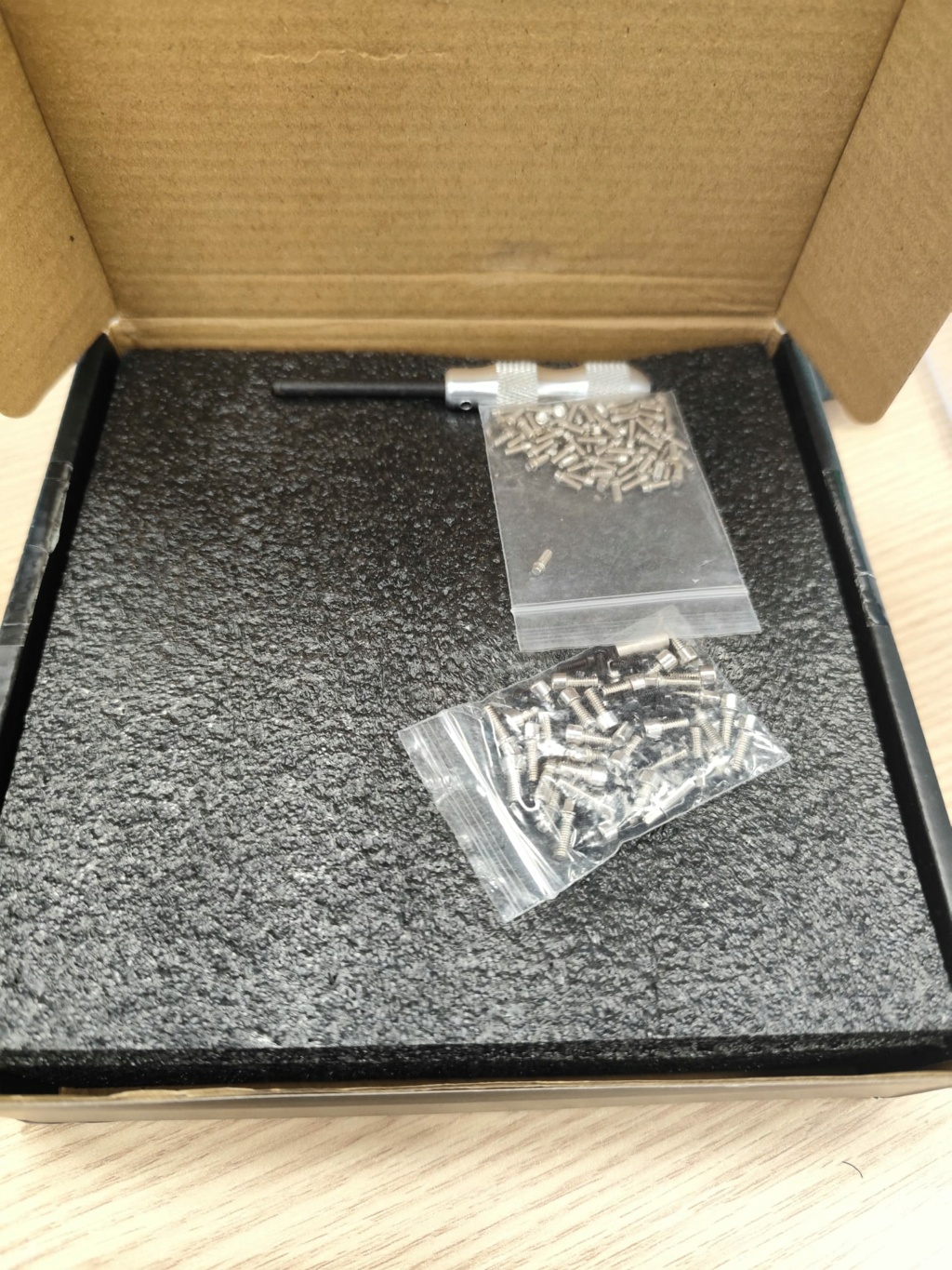

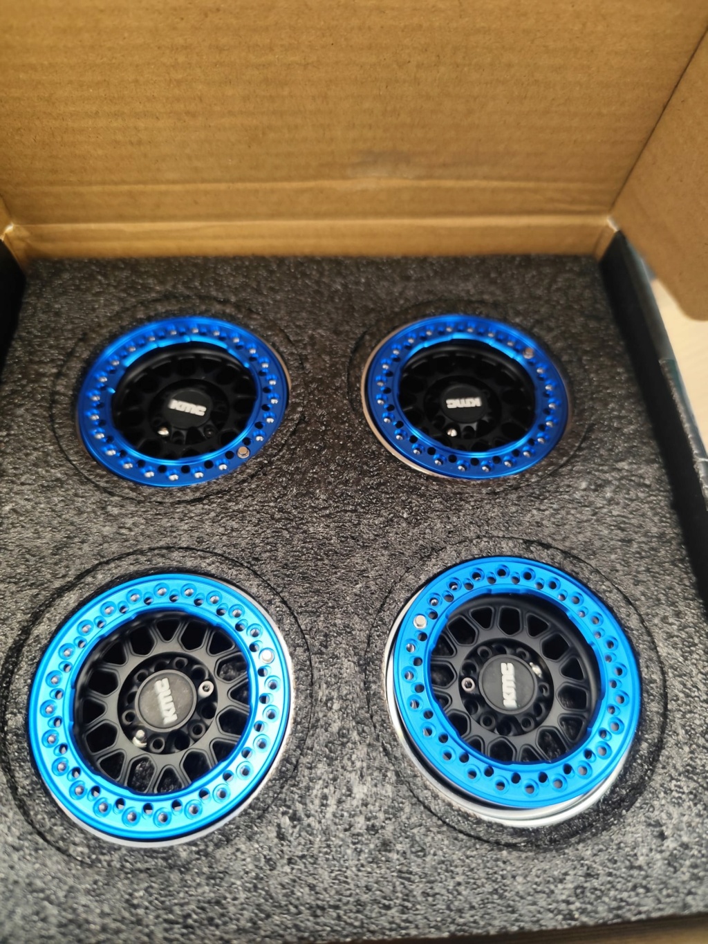

more arrived parts , happy weekend !!

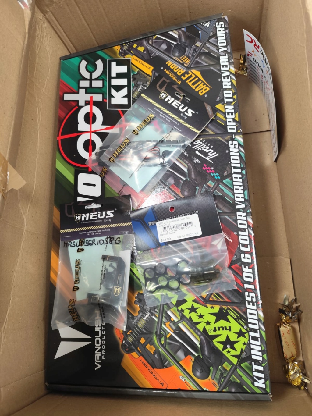

That for the moment , and waiting for :

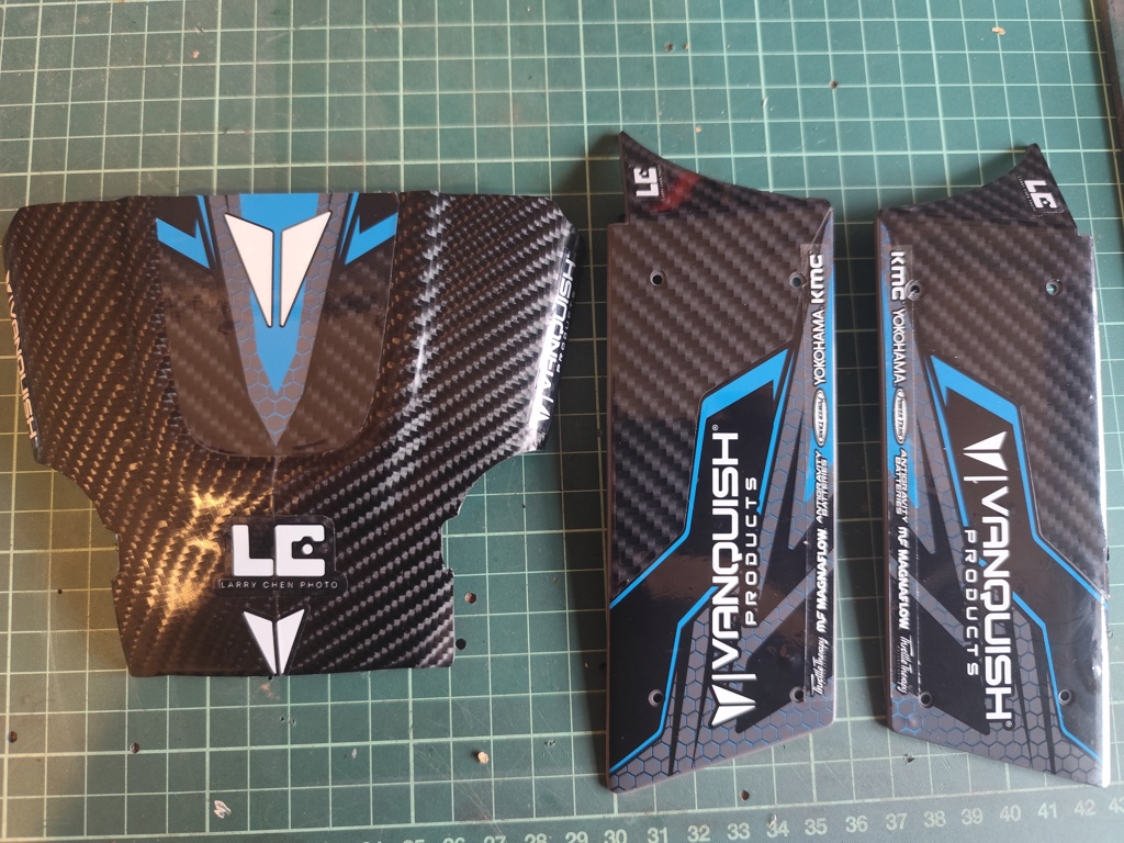

Very cool! Are you doing it up with the box art? Or are you going to do some realistic weathering? I'd love to see one of these all rusted up and filthy! 😉
I don't know if I'll put the one in the bag, I'm looking for some Libery that I like, but I'm sure not to add rusty.

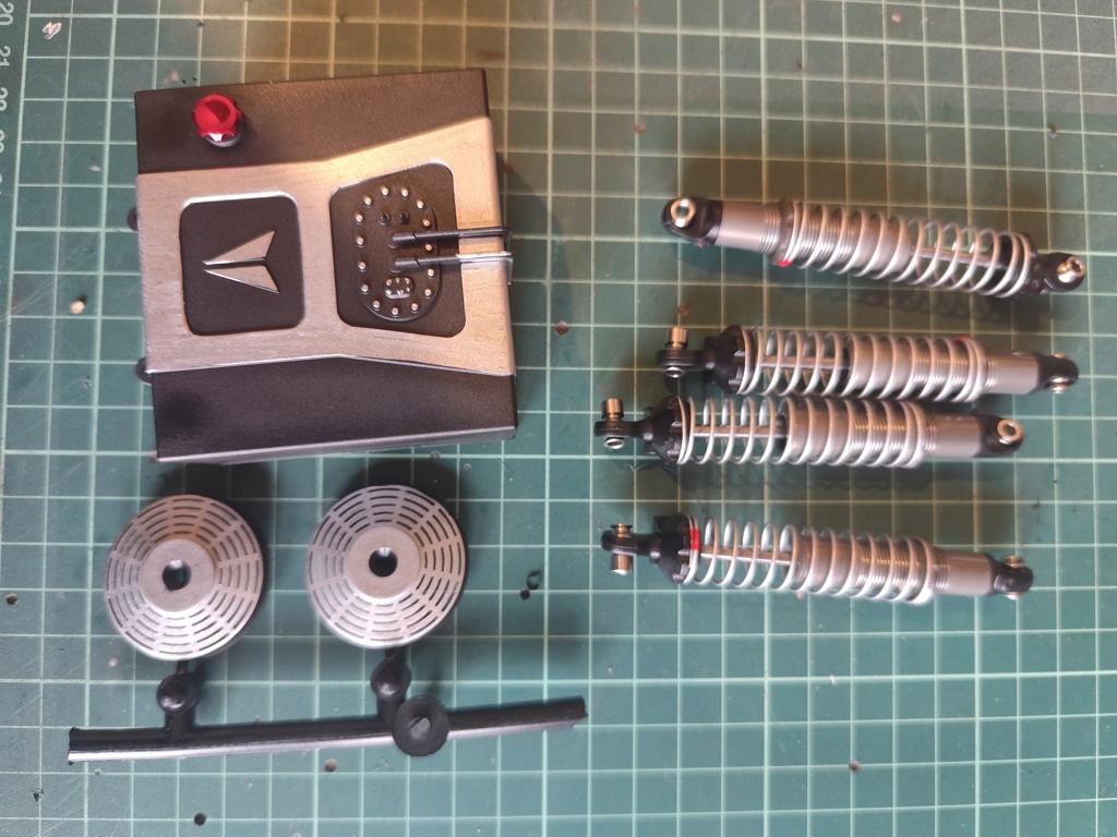

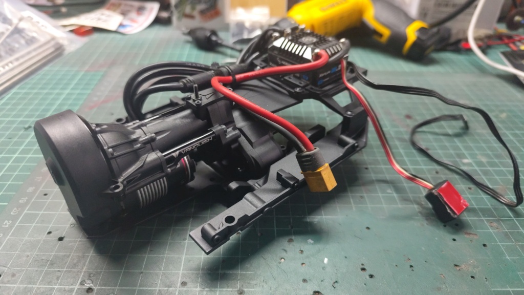

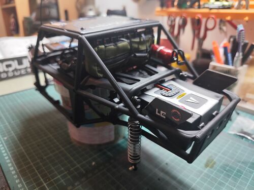

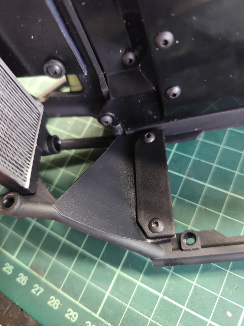

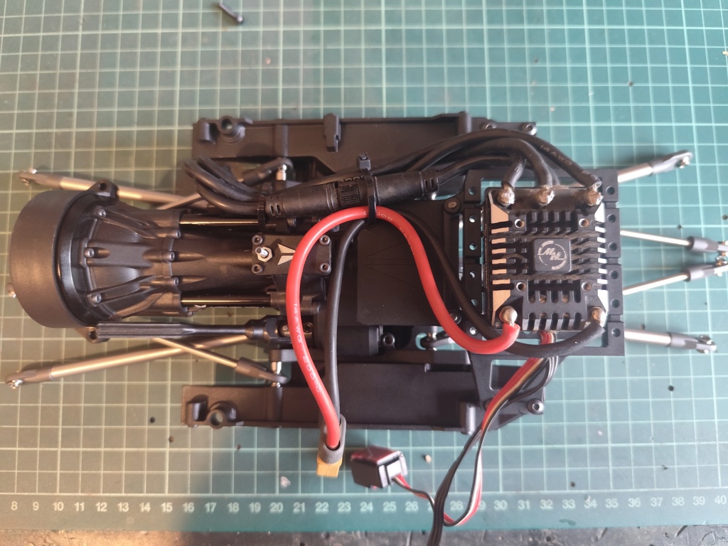

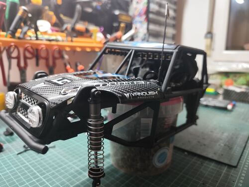

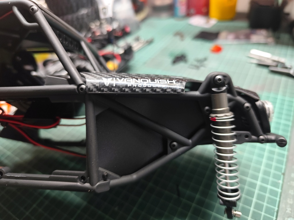

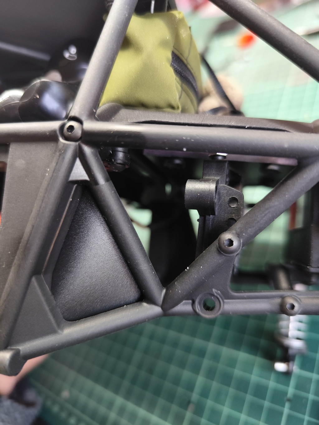

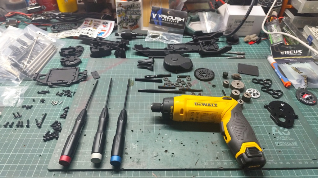

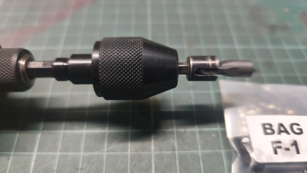

A productive morning, tranny mounted with the overdrive and a screw to simulate the gear shift lever :

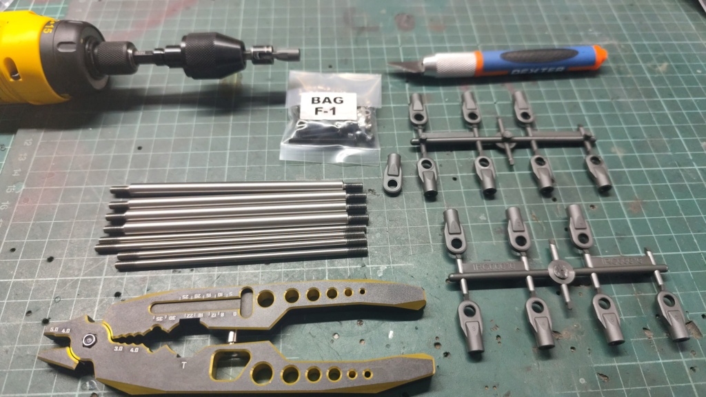

Then the links, I I have made a support with an old joint so that I can screw the ball joints in faster and without suffering hahaha and everything is placed in the support of the tranny

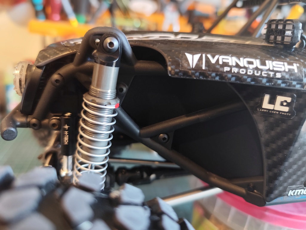

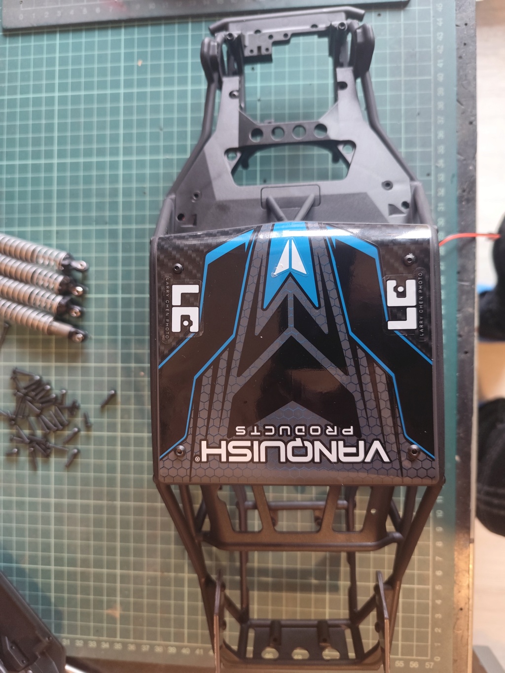

I have also mounted the shock absorbers with 650w front and 900w rear, and I have made some progress with the paint and bodywork issue
and up to here all the work of the sunday

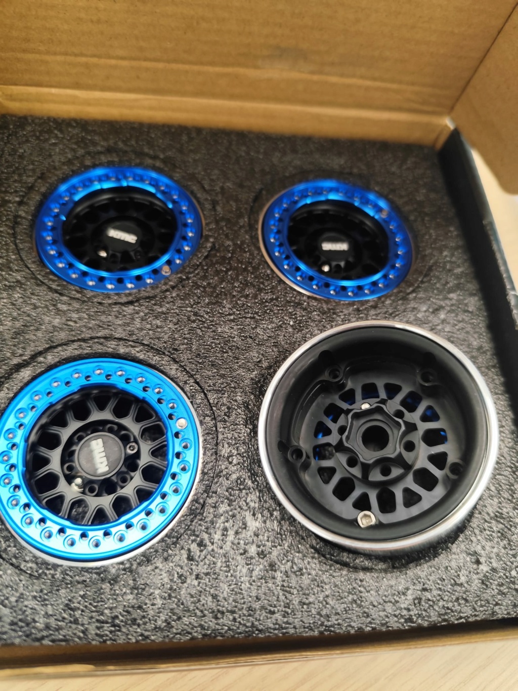

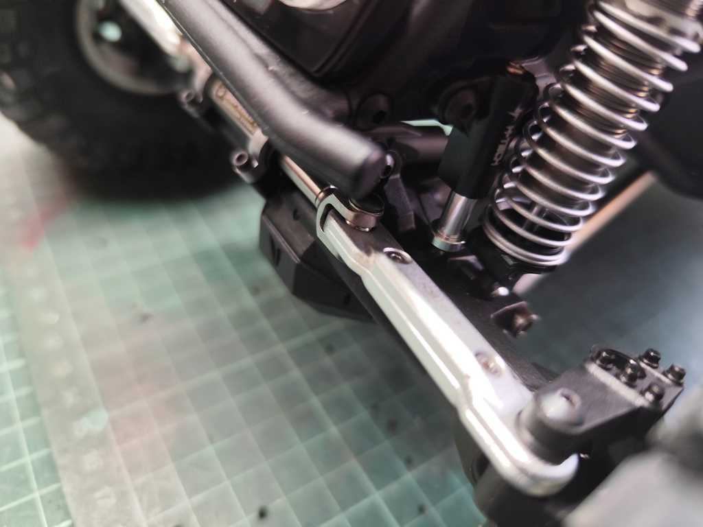

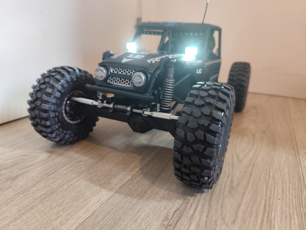

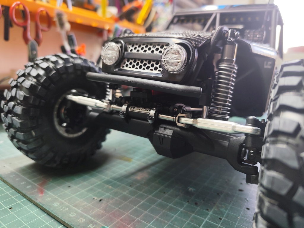

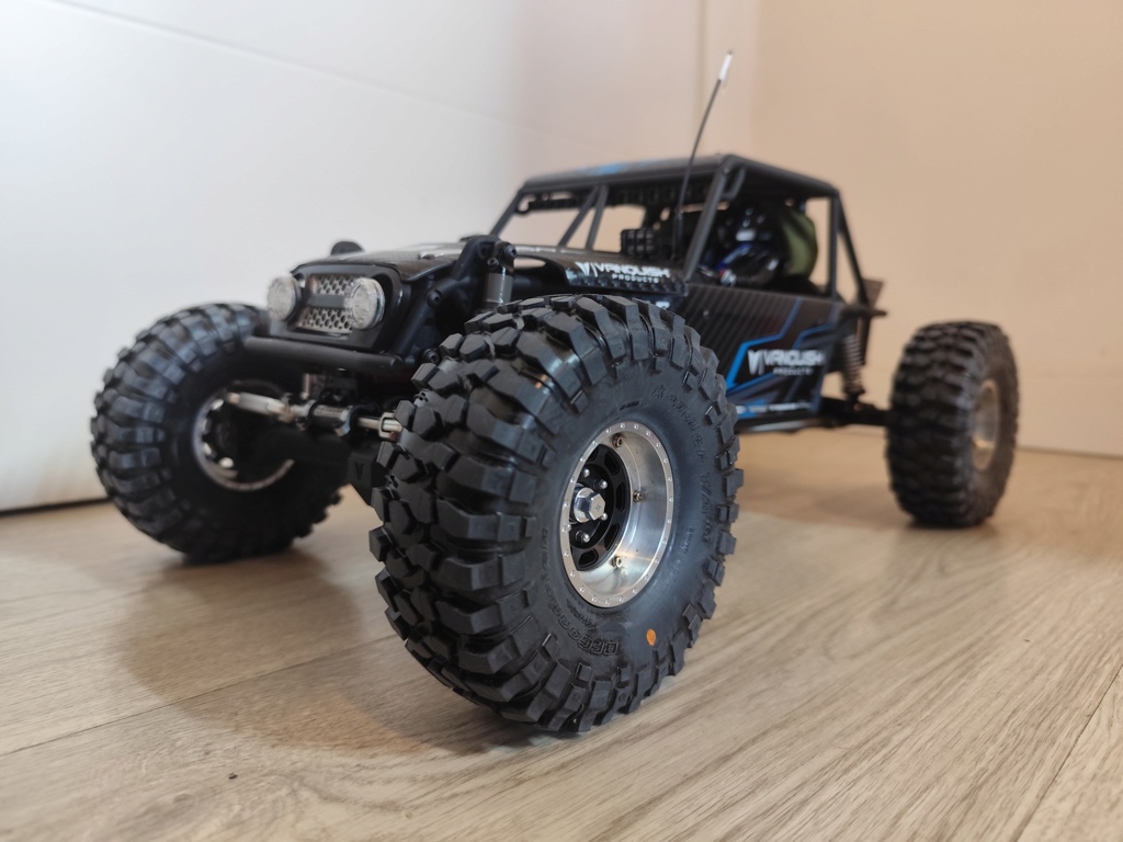

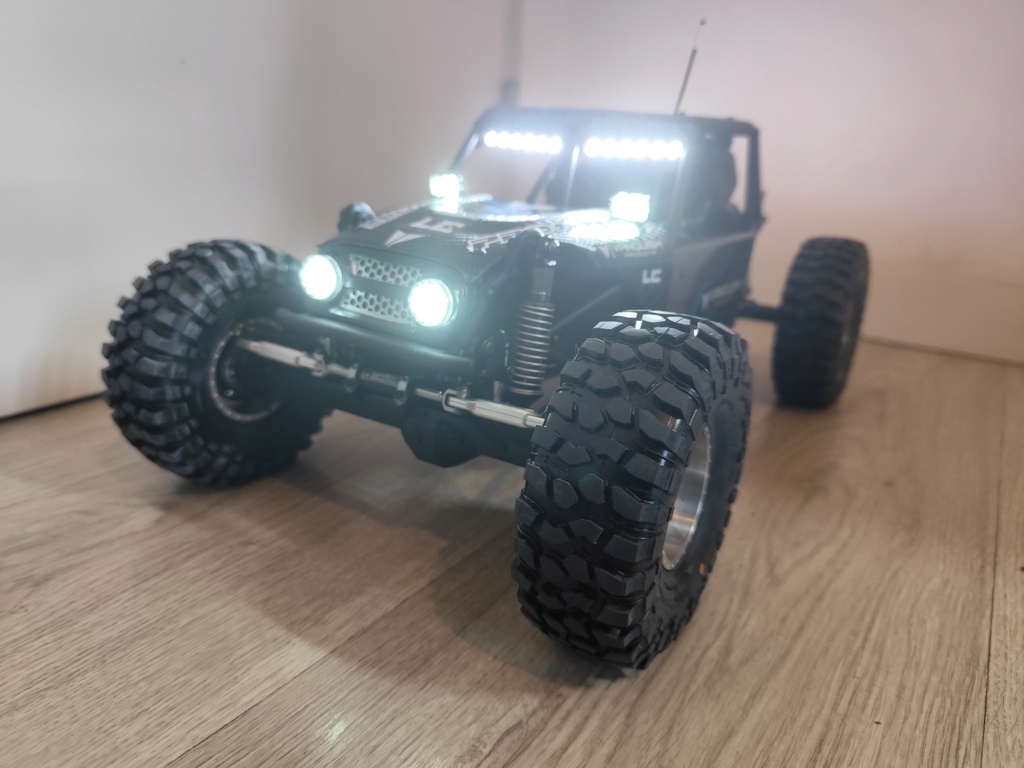

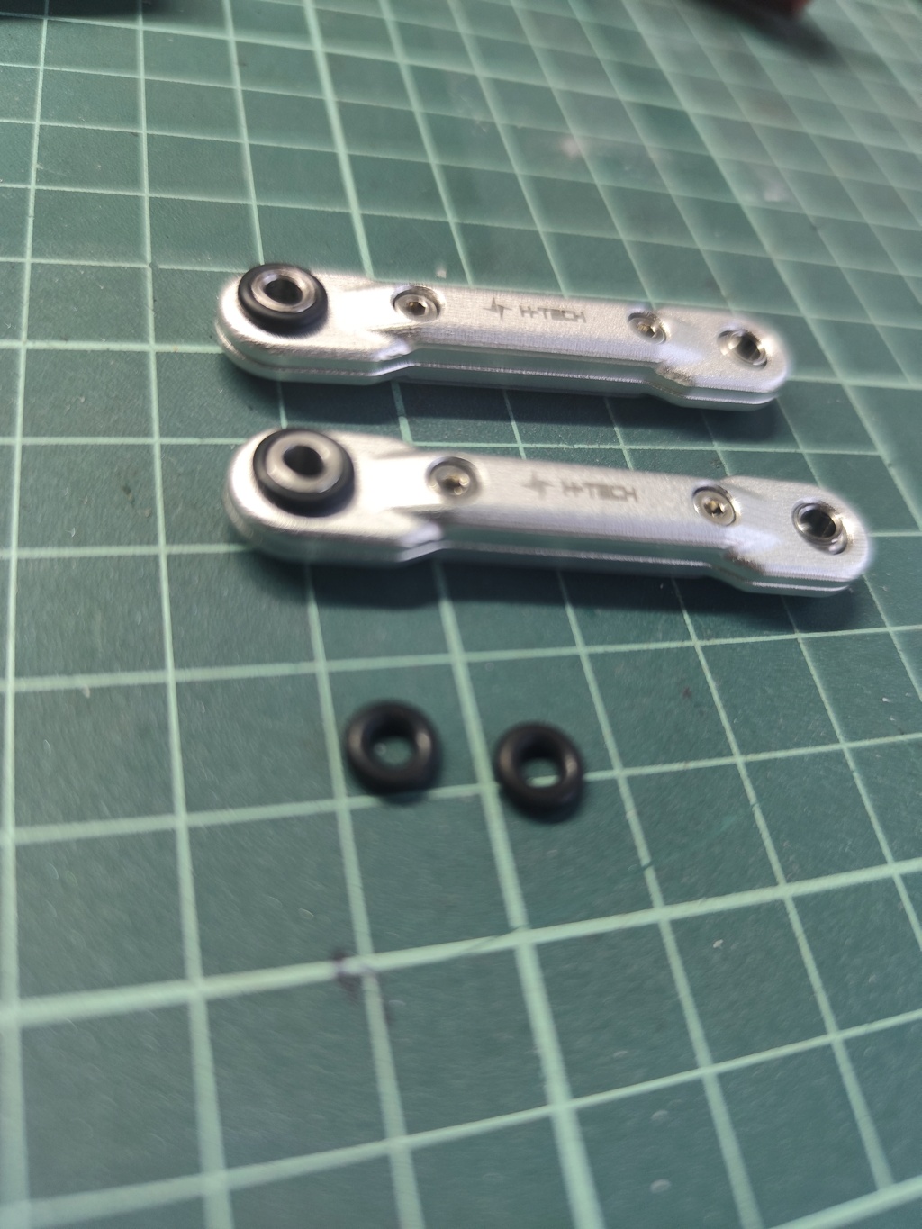

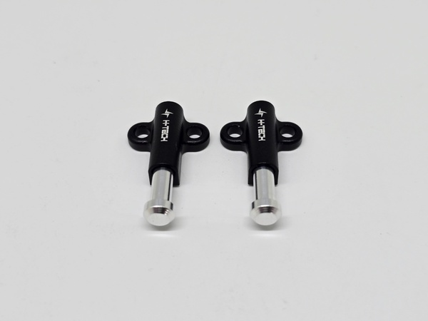

In the end I only mounted the bearing supports, the third aluminum member left a little slack and did not rotate as smoothly
To prevent the steering links from moving a little and thus prevent them from hitting the axle housing and getting stuck, some O rings in the balls of the links and problems solved

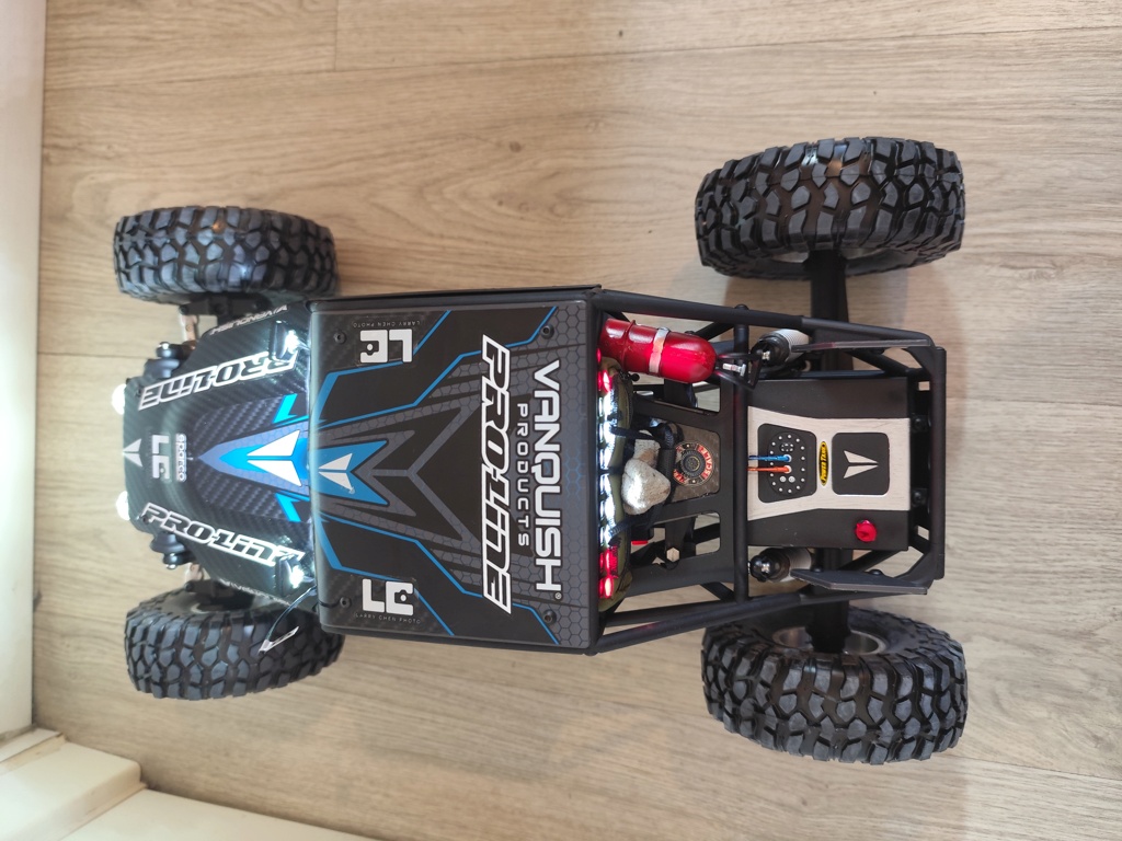

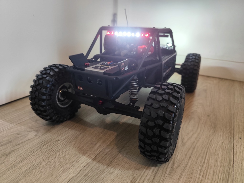

With all this, finally finished, now we have to try, I would also like to reduce the battle a little but I will try another time

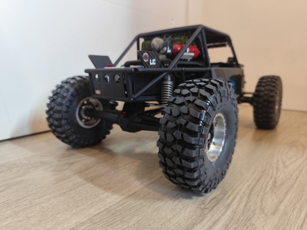

So you have the sickest, rusty, banged up, realistic looking scalers on this forum, and now you build this. I really don't like you 😜
Awesome build bro. That thing is beautiful.
