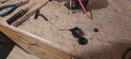

Have to say guys iam getting pretty good at this .it only took me 3 hours this time around so therapeutic 4th time fixing this one lol needs a longer string i think
I made this to help, had to file the bolt head just a touch on this one to make it fit. It really helped me. One thing to be cautious of with it is - it can almost make it too easy; I went one more turn and snapped the spring, now I cannot find a new recoil or spring for this dumb thing. So, adding a longer string, be careful doing that. I am not sure how to tell you how long the string should be for yours.
