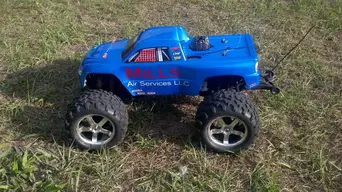

Here is my 4907 T-maxx
Here is my T-Maxx . Nothing special . I have about a $50 a week habit , I mean hobby . I am on my third motor in 6 months . 6 clutch bells , 20 plastic spur gears (Tried metal but went back to plastic) 20 sets of clutch shoes , 10 CB bearings , 1 fuel tank , 12 sets of A arms ... Where does it end ???
I am a daily basher and crasher . I jump cars and run over dogs . Woops.
I am going to upgrade to some RPM parts . I will post more pics later . Now I just figured out how to upload pics HEHE.
BTW . Thank you everyone for helping me keep this rig going . This site is my number one goto for everything RC .
