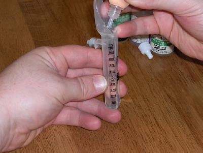

Now it's time to mix. You need to find something that measures in ml, cc or something. I happened to have one of those little plastic spoons the pharmacy gives you when they give your kid antibiotics. I personally think the ideal tool for the job would be a syringe. You don't have to get medical though. Remember, you can use anything. Maybe you've got a 1/4 teaspoon measuring spoon. You could fill it up 7 times with 10K and 3 times with 3K and mix up some 7K in a bowl or something. (Just don't eat
it! lol). Anyway, here's a pic of me doing the mixing:
Blends
If you're using a tube like I am remember that you want to measure to the bottom of the bowl-shape the fluid makes at the surface (meniscus). Also, remember that if you get fluid on the side of your tube, you'll have to wait a good deal of time for the thick fluid to run down the sides to get a
good measure. With the first fluid, you have a little play. If you put too much in, you can stick something into the tube and pull out a little that clings to it as you remove it. With the second fluid, just add it to the first and just it in slowly until you get to the target amount. Go slowly, rushing this will only cause you grief when you add too much of the second fluid.
If you're lucky enough to have a syringe on hand, all you need to do is suck up X number of cc of fluid A and then Y number of cc of fluid B or until the syringe holds the target amount. Next you only have to squirt the combined fluid into your container and mix.
After you mix your fluids together (I used a chopstick to stir it), you need to find a container to hold the new mixture. I was lucky enough to find the two small diff fluid bottles to be empty when I was
done. Ironically enough, they hold exactly 10 cc each. The warning I have when you're doing this is to be sure and allow all of the old fluid to drain out of the container you're going to use. I put hung my spoon measure thing off a cup to let the 3k bottle drain for about 10 minutes.
