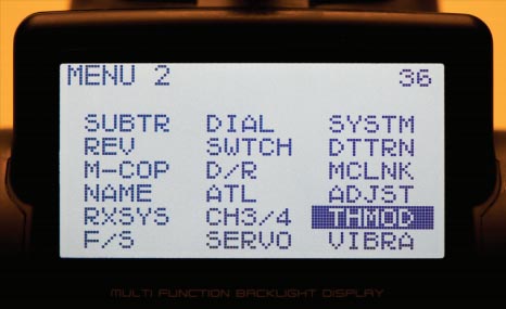

  1. Pull up Menu Screen 2.
  2. Scroll to and select “THMOD.”
    Futaba 4PKS-R update1

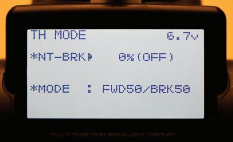

  3. Scroll to “50/50”
  4. Hit the “+” button.

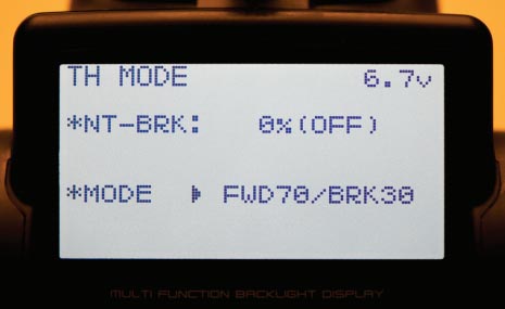

    Futaba 4PKS-R update2
  5. Throttle Mode will automatically reset to 70-30.
  6. Turn radio off, then on again.
    Futaba 4PKS-R update3
