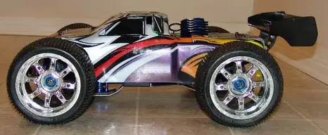

Hi Guys,
Here's a picture of the Tekno Revo Wing Kit installed.
Steve Wang
Maxx Truck
www.maxxtruck.com
