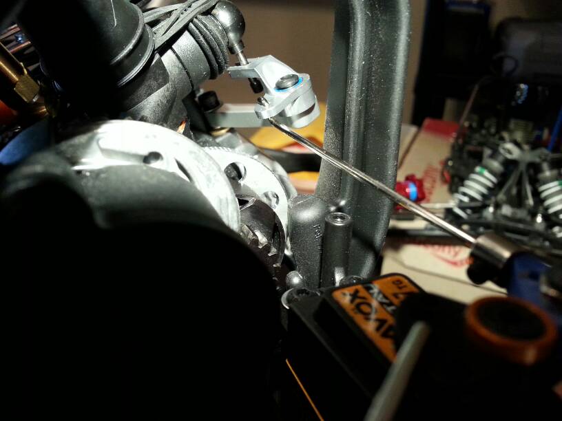

I've got it about 98% sorted the only thing I'm not sure is where to mount the supplied throttle return spring
I use hair bands, but you can see a post behind the throttle/brake servo. You slide the closed hoop end of the spring over a screw and screw it into the top of that post. Then put the hook end through the throttle mixer where the linkage goes.
thanks for the pics that clears a few things up.
I was putting the finishing touches on last night , I ended up using the stock throttle return spring and screwing that to the roll bar but I was having a hard time getting full throttle it seems the linkage provided with the new era kit isn't very strong and flexs a lot so I was trying everything to get it and that's when it happened......I over tightened the carb arm on the carb and cracked it so now its stuffed.
