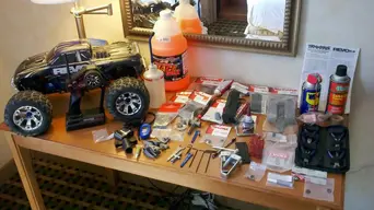

Towards the end of the first gallon of nitro I hit a curb at my hotel and broke both left front a arms and push rod... and the box with the reciver was smashed up. I've also had two clutchs in this point and a experience with the slipper clutch.
Today I put on two new aluminum pushrods. The 102mm pushrods apparently are shorter than stock? I ended up having the push rods connect to the furthest in hole on the front a arms and moved the rear push rods to the middle hole. It gave the truck a desert truck stance... I installed the stiffer springs the kit came with but left the stock p2 rockers on. Without driving it, I thinks its going to handke much better with less body roll and take big lands better. I'm sure I will have the address the stance later to make it handle better under power.
Pulled the engine and sealed everything. Seems there is a 'lot' of slop at tdc. Is this normal? Besides that, everything looked great. Glo plug looks pretty good after a gallon of 20%, but I put a new one in anyways.
While I was hear I pulled that junk clutch and installed a kompsite buku setup with the stock bell (after a good sanding and cleaning). Two brass shims seemed like the perfect spacing for the flywheel from the engine, but it was damn close so I put in three. Though I bought ten new ones, the stock clutch bearings looked and spun great so I reused them. I didn't use any spacers up front and everything worked beautifully.
Installed the engine after sealing everything and set the mesh... then hooked up up the throttle stuff to find... the carb should be spun a smidge more clockwise. It was binding up in the carb slide and the servo couldn't get the carb to WOT and it would return to like 1/4... not idle. At this point I would have to pull the engine.. pull the siliconed carb. Clean and reseal it (hope my positioning is better) and reassemble.
Not wanting to do that... I managed to get the carb returning to idle smoothly and opening 98% of the way. Took a lil fanaglin, and loosening the set screw to that throttle arm on the carb slide, and givin it a small rotation. We'll see how this works before I decide to pull it apart to fix the carb position.
