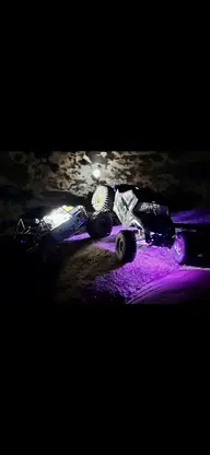

My rig
This is my dedicated crawler.
General RC Information
Custom crawler build:
  • Shock keys
  • TREAL SCX10 III/Capra Overdrive Portal Gears Harden Steel Gears (15T/20T),Overdrive 43%
  • INJORA RC Internal Brass Counterweight 2pcs 63g Brake Disc Weights
  • OGRC 1.9 Inch Brass Internal Beadlock Ring Clamp Ring 110g
  • Brass Inner Outer Portal Drive Housing Steering Knuckle(200g)
  • High Torque 40KG Digital Servo, DS3240MG Full Metal Stainless Steel Gear Waterproof Steering RC Servo
  • HobbyPark Aluminum Center Frame Brace Transmission Skid Plate
  • ProTek 25T Aluminum servo horn
  • Capra aluminum servo mount
  • Hoovo 3s Lipo battery
  • Proline cliffhanger body
  • 120mm RCLions scale shocks with 75% droop, 25%sprung
  • Spektrum Firma 2-in-1 Brushless Crawler Motor/ESC: 2300Kv
  • SUNGOOYUE 1.9Inch Beadlock Wheel, 4 Pcs Brass Heavy Crawler RC Wheel 2.2lbs
  • 2.2 Proline Hyrax tires
  • OGRC Silicone Rubber Tire Inserts Foam
  • INJORA RC Internal Brass Counterweight 63g Brake Disc Weights on front axle
  • Crawler All Metal Front and Rear Portal Axle for Axial Capra 1.9 UTB Buggy F9 CNC Machined 7075 Aluminum
  • Full Metal Assembled Transmission Case Center Gearbox with Steel Gears
  • 50hp in stickers! Duh!
  • AMK 68-229mm Severable Ruled SCX10 Driveshaft Stainless Steel TRX4 Drive Shaft for 1/10 RC Crawler Sportys Scalers GSPEED
  • AMK Carbon Fiber LCG Chassis Rails, Gen2 RC Frame Rails for 1/10 RC Rock Crawle, 72g Lightweight Thickened for 1/10 RC Rock Crawler
