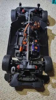

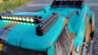

My 1st brushed to brushless conversion. It was quite fun without many issues. Lots of research and great satisfaction completing it. I've got a new Mustang body for it, waiting to be sized and painted.
General RC Information
Motor: Hobbystar 3674/2650kv
ESC: Spektrum 4s 120A
Receiver: Radio Link – R6FG
Servo: DS3235-Pro 35kg with Kimbrough Servo Saver
Current Diff Fluids: 20/10
Current Shock Fluid: 1k cst
Current Gearing: 50/17
Current Tires: Gold Hoons
Top Speed: 60mph
  • Fast Eddy Bearings
  • F/R CNC Steel EXB Diffs with Hot Racing Aluminum Yokes
  • BLX Aluminum Motor Mount
  • 2x Power Hobby Tornado Aluminum Fans with Aluminum Mount
  • Center Drive Shaft High Speed Support with Bearing
  • Hot Racing Aluminum Center Drive Shaft
  • Carbon Fiber Center Brace (Ram-Jam Racing)
  • Carbon Fiber Upgraded Side Panels
  • Carbon Fiber Front Splitter
  • Carbon Fiber Rear Wingless
  • Carbon Fiber GNSS GPS Speed Holder Case
  • Front, Roof, Rear Light Kit
