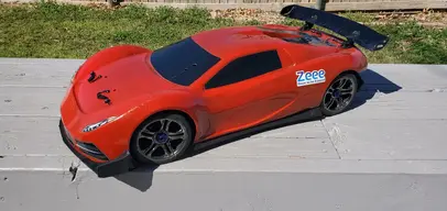

This picture is what she looks like today.

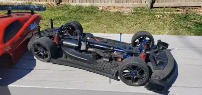

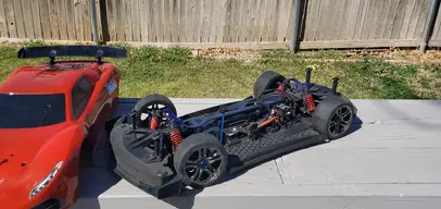

Here's some pictures without her body
As you can tell she's mostly stock except for velcro battery strap mod just 20 x 500mm Apex RC straps wrapped under the stock battery holders since i run my two Zeee 3s 6,200Mah hard case batteries in this car. I also have a GPM Aluminum bellcrank in Blue as well as sway bars

Traxxas 2022 XO-1 stock custom painted body in Red with Arrma 1\8 body clips with lanyards.

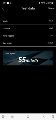

Current top speed (Running on 6s with 16p\46s).
