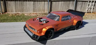

Hi everyone, Thanks for stopping by to my Arrma Felony Serena II Project i bought this car as a slider\roller off eBay along with the orange stock body and a couple of months ago i bought my first set of Hoons for her in Silver compound. And i've been running her for the past two months every now and again and i also put her onto a new Transmitter a Spektrum DX6C with an AVC SR6200A receiver and she was great. I also put in my XO-1's old HW Max 6 G1 combo for now as i wanted to get her running this to run along side my XO-1 Serena. But maybe someday i'll buy her a new MMX8s to use with my old 1717 sensored motor since i stole my older MMX8s for my XO-1 earlier this month.
Here's a pic of her currently.

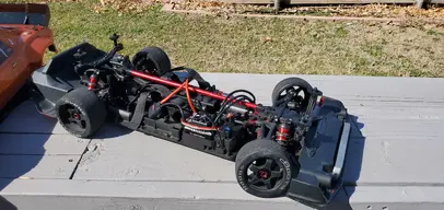

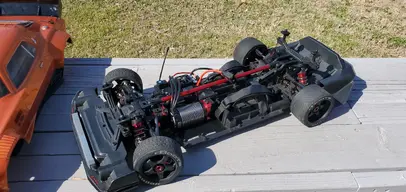

An under body pic.
Here's her current setup.
Hobbywing Ezrun Max 6 G1 V3 160A Brushless Sensorless ESC
Hobbywing Ezrun 4985SL Sensorless 1,650kv Brushless Motor
Perfect Pass QS-8 V2 600A 8mm connectors soldered on both ESC and Battery leads
Arrma Safe-D5 Mod 1 16 Tooth Steel Pinion gear meshed to Stock Arrma 46 Tooth Mod 1 Spur gear (May gear up to a 21 - 23 tooth depending on conditions someday)
Amazon Special DS3225MG 25kg Servo (Have plans to upgrade to a Perfect Pass Monster 1\10 - 1\8 56kv Brushless HV Servo someday)
Spektrum DX6C 6 Channel DSMR 2.4Ghz Digital computer Transmitter bound to a Spektrum SR6200A 6 Channel 2.4Ghz Receiver with AVC (
Currently running x2 Zeee 6,200Mah 11.1V 120C 3s LIPO Batteries both with Perfect Pass QS-8 V2 Connectors in Series to make 6s
Arrma Dboots Hoons 42\100 front and 53\107 rear all in Silver compound
Stock shock and diff fluids
Stock 15\42 GP5 front and 14\46 GP6 diff gears
Stock Orange body with black wing and Included twin turbo hood accessory kit and front mounted Intercooler with rubber hosing
