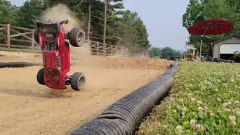

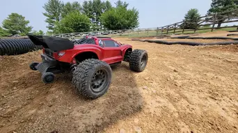

Just a few upgrades. This was my most recent Arrma purchase (2022). Little thing is pretty Spunky! I did order a new body for it. PL 2022 Ford F-150 Raptor.
General RC Information
Motor: (Stock) Spektrum Firma 3660/3200kv
ESC: (Stock) Spektrum Firma 100A
Receiver: Radio Link – R6FG
Servo: Dover RC HV Digital Servo 35kg
Current Diff Fluids: 50/30
Current Shock Fluid: 550 cst
Current Gearing: 57/18
Current Tires: (Stock) dBoots Katar
  • Mojave Front Shocks on Rear
  • Axial Silicone Shock Bearings
  • Arrma Aluminum Center Brace
  • Hot Racing Steel Spur
  • Hot Racing Aluminum Pivot Balls
  • Fast Eddy Bearings
  • Hot Racing Aluminum Center Drive Shaft w/ Aluminum Center Driveshaft Support
  • 1x 30mm Surpass Rocket Motor Fan
